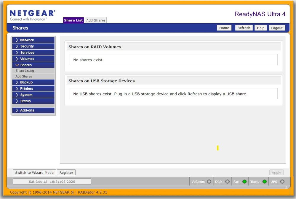

When I log in to ReadyNAS Frontview as ADMIN, the [Share>Share Listing]  states, "No shares exist."
Prior to this, the share existed for years unchanged.

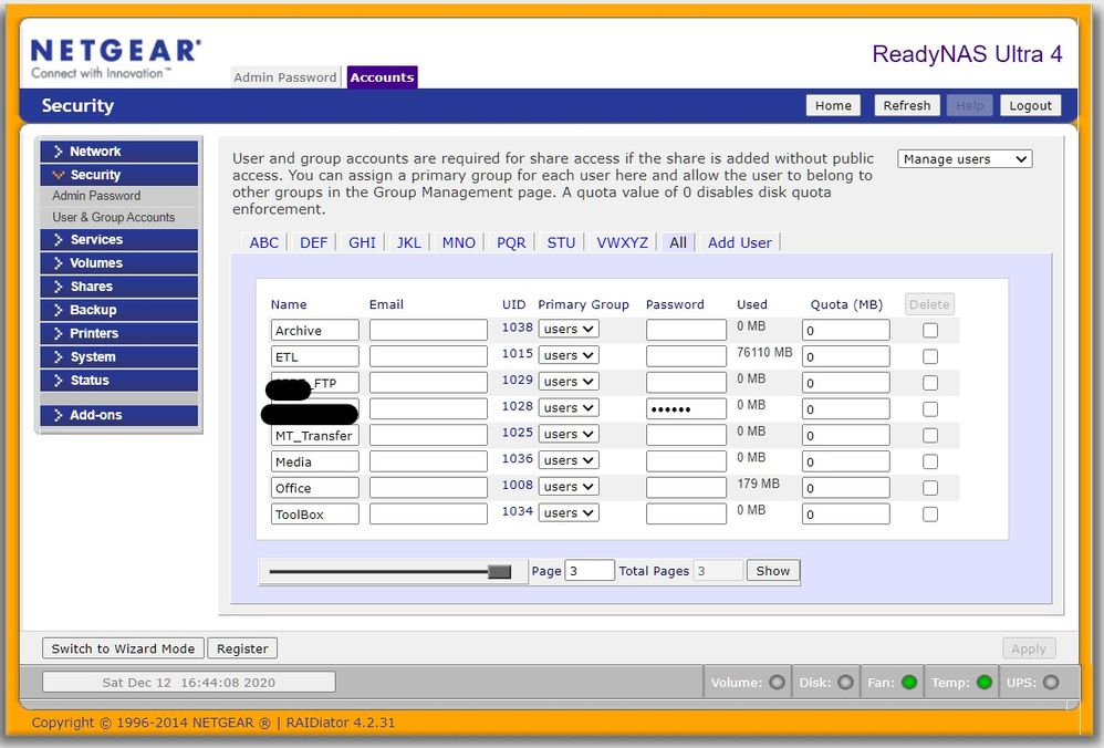

It looks like something was corrupted, because the SHARES are showing up among the list of USERS in the ReadyNAS Frontview menu, [Security> User & Group Accounts]. See image below:
The image above, each entry in the "Names" field with a blank entry in teh corresponding "password" field is actually a defined SHARE.
Actual, correct "Users"  and "groups" remain listed, intermeshed with shares in the ReadyNAS Frontview menu, [Security> User & Group Accounts]

      The shares being listed in the list of users is a carry-over from the legacy Share security mode that was discontinued several years ago. Frontview looks at the samba Shares.conf and if the system is not in Share security mode it realises that the shares are not users and filters those out. However if shares.conf is corrupt or blank it won't realise that the shares are not users.
