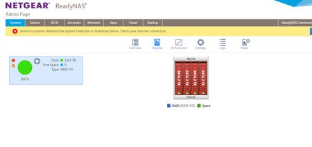

Sory of my english. I have a RN214 and RAID 10 encryptynt, after restart NAS say Volume is Inactive or Dead. Please Help msdata.log Personalities : [raid0] [raid1] [raid10] [raid6] [raid5] [r...

There are btrfs errors on the volume that are preventing it from being mounted:
Nov 27 10:01:59 SERVER_DB kernel: BTRFS: device label 568ac913:DATA devid 1 transid 872625 /dev/dm-0 Nov 27 10:02:00 SERVER_DB kernel: BTRFS info (device dm-0): setting nodatasum Nov 27 10:02:00 SERVER_DB kernel: BTRFS info (device dm-0): has skinny extents Nov 27 10:02:00 SERVER_DB kernel: BTRFS error (device dm-0): bad tree block start 7909885094943733730 17950356111360 Nov 27 10:02:00 SERVER_DB kernel: BTRFS error (device dm-0): bad tree block start 7909885094943733730 17950356111360 Nov 27 10:02:00 SERVER_DB kernel: BTRFS warning (device dm-0): failed to read tree root Nov 27 10:02:00 SERVER_DB kernel: BTRFS error (device dm-0): bad tree block start 7909885094943733730 17950356111360 Nov 27 10:02:00 SERVER_DB kernel: BTRFS error (device dm-0): bad tree block start 7909885094943733730 17950356111360 Nov 27 10:02:00 SERVER_DB kernel: BTRFS warning (device dm-0): failed to read tree root Nov 27 10:02:00 SERVER_DB kernel: BTRFS error (device dm-0): bad tree block start 14399094478400985867 17950316724224 Nov 27 10:02:00 SERVER_DB kernel: BTRFS error (device dm-0): bad tree block start 14399094478400985867 17950316724224 Nov 27 10:02:00 SERVER_DB kernel: BTRFS warning (device dm-0): failed to read tree root Nov 27 10:02:00 SERVER_DB kernel: BTRFS error (device dm-0): bad tree block start 11221268990985196159 17950313840640 Nov 27 10:02:00 SERVER_DB kernel: BTRFS error (device dm-0): bad tree block start 11221268990985196159 17950313840640 Nov 27 10:02:00 SERVER_DB kernel: BTRFS warning (device dm-0): failed to read tree root Nov 27 10:02:00 SERVER_DB kernel: BTRFS error (device dm-0): bad tree block start 16618288268865450296 17950312431616 Nov 27 10:02:00 SERVER_DB kernel: BTRFS error (device dm-0): bad tree block start 16618288268865450296 17950312431616 Nov 27 10:02:00 SERVER_DB kernel: BTRFS warning (device dm-0): failed to read tree root Nov 27 10:02:00 SERVER_DB kernel: BTRFS error (device dm-0): open_ctree failed
You could engage Netgear paid support for data recovery: https://kb.netgear.com/69/ReadyNAS-Data-Recovery-Diagnostics-Scope-of-Service
If you have linux skills, you could also use ssh and attempt to repair it yourself.
