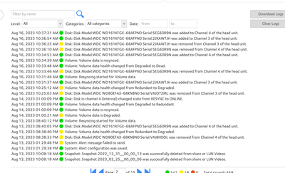

I am unable to access the drives / data on my Netgear ReadyNAS with four drives in RAID5 configuration with the following error in the UI:
> Remove inactive volumes to use the disk. Disk #1, #2, #3, #4
I am a panicked dad who may have done something incredibly silly. I am using the ReadyNAS RN424 and was trying to increase the capacity since space was running low by purchasing individual 16Tb drives, letting them sync / replace the existing 8Tb drive, and then continuing to move on until all four drives were replaced.
However, this morning I did the following set of steps, and now my ReadyNAS is showing _all_ drives as inactive and I cannot recover the data and get the volumes to mount. Here is what I did (in full transparency, learn from my mistakes!):
1. Last week, I swapped a drive (slot 4) from 8Tb to 16Tb, and it successfully re-built / updated to the new drive in about ~24 hours
2. Today, I replaced the second drive (slot 3) with a 16Tb drive and it was about ~0.2% replaced (2-3 minutes) when I realized that in installing the previous drive (slot 4) I didn't add the plastic drive mount to the previous drive so it was working but "floating"
3. I (foolishly) pulled out the previous 16Tb drive (slot 4), and then re-mounted it with the plastic mount and re-inserted the drive
So, at this point I have three (working) drives in position, 1, 2, and 4 and drive 3 (which should be re-building). What happened instead is drive 3 and 4 both show as needing to be replaced, so I rebooted.
Upon reboot, now _all_ drives show as needing to be replaced presumably because of my actions. I panicked a bit, and then swapped drive 3 back to the original drive, which as of now as not worked (I also have rebooted a few times, just to try the whole "turn it off and on again" approach that frequently works)
I have the logs saved in Google Drive, and can message anyone who is willing to help with the logs. The key moment is at 1033AM PST, which is when the NAS went from "degraded" to "dead." I have also attached a few screenshots from the UI and the logs. I have checked in a few files, notably sytstem.log, kernal.log, etc. but nothing illustrative yet and frankly I don't know what to look for!

- dschauAspirantSome maybe illustrative (and concerning) messages in kernal.log at that 10:33 timestamp. Aug 16 10:33:46 NAS kernel: sd 8:0:0:0: [sde] tag#17 Add. Sense: Unaligned write command Aug 16 10:33:46 NAS kernel: sd 8:0:0:0: [sde] tag#17 CDB: Read(16) 88 00 00 00 00 00 02 da 19 80 00 00 05 40 00 00Aug 16 10:33:46 NAS kernel: blk_update_request: I/O error, dev sde, sector 47847808and then a number of failures:Aug 16 10:33:46 NAS kernel: sd 8:0:0:0: rejecting I/O to offline deviceand then other errors like:Aug 16 10:33:46 NAS kernel: sd 8:0:0:0: [sde] tag#18 Add. Sense: Unaligned write command

- dschauAspirantOK, so first and foremost,StephenB is an absolute legend. He took time out of his day to review the logs, and write an amazingly detailed guide for how to fix it. I'll summarize the high-level points with a disclaimer... if you're reading this, perhaps your issue is different. This is how I solved my issue, and Stephen was able to look into the logs to know this was the issue. 1. I removed the drive in slot 3 (the original one I tried to hot swap) 2. I re-booted the device in Tech Support mode (power down device, hold reset switch, power up device, keep holding reset switch, choose tech support mode) 3. I connected to the device with telnet (telnet ip-address-here) using root:infr8ntdebug Then, I ran the following commands: 1. rnutil chroot (I think this logs me in to root user or something?) 2. mdadm --stop /dev/md127 (stop active partition) 3. mdadm --assemble --really-force /dev/md127 /dev/sda3 /dev/sdb3 /dev/sdc3 4. btrfs device scan 5. mount -r ro /dev/md127 /data At this point, I had a working /data partition (huzzah) that I could inspect with ls (e.g. ls /data) and which showed the data I'd expect, as well as additional data for the Netgear device. Finally, I BACKED UP the critical data just to avoid this issue going forward -- and also set up an rclone while I was at it to keep it up-to-date -- and then I inserted the new drive into slot 3 which is now being recovered. A journey, but the destination was beautiful. Thank you again to StephenB, you are a lifesaver, and a saint. - StephenBGuru - Experienced UserI'm glad I was able to help.
