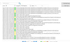

ReadyNAS RN424 | Inactive Volume + RAID Issue
 Hello!     I am unable to access the drives / data on my Netgear ReadyNAS with four drives in RAID5 configuration with the following error in the UI:     > Remove inactive volumes to use the disk. Di...
