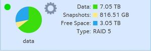

ReadyNAS 314 - F/Ware 6.10.4 hotfix 1 - 4 x 4TB WD Red in XRAID This has been working fine for a number of years - until the past week or so. Network drives mapped from 4 different Win10 PC's...
