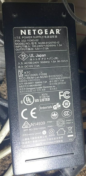

Replacement power brick for ReadyNAS 204
Hi, My current power brick comes on for about 5-10 seconds then goes out - the light on the power brick is actually going out. Tried a new fuse and 3-pin cable completely with no difference. I'm re...

Look for a third-party one for a Synology DS410/411/412, which have the same pin-out and slightly higher input current requirement.. Plenty of options on Amazon in the $25US range.
