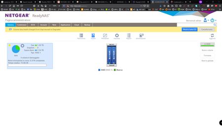

Stephen thanks, but maybe there's something wrong.....as you can see in the attached picture, at the end of the Sync, both the disks are online (both have green led) but the blue little window on the left of the screen still show "il volume è danneggiato" (volume damaged)....
............Some suggestion to fix the problem?
- StephenBNov 22, 2020Guru - Experienced User
What are you seeing on the log tab?
