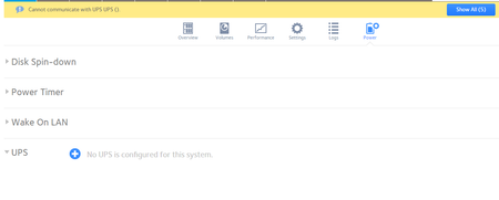

RN104 Cannot communicate with UPS
Hello everyone and anyone that looks at this, I'm having an issue where my RN104 will not stay connected to the UPS. It will show up on the front screen of the RN104 and in the admin page for a few...

I have tried moving the cable to each of the usb ports on the RN104 but have seen no improvement in the stability of the communication between the RN104 and the TrippLite.

So in light of not getting any more help other then "did you try a different cable/port" I ended up looking and finding a small APC UPS (600M1) as I have seen in other post that they (APC) are the most likely to play nice and communicate with ReadyNas systems.
Ive run a test with the rn104 only connected to the APC by the USB and ran a work light to drain the UPS down to trigger the RN104 graceful shutdown. worked perfectly.
