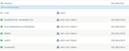

rn314 network set-up in my home network
Hello, I have the following network set-up at home on my Fritzbox Router 4590: I recently added a second RN314 as back-up-NAS to the network named "FamilyNAS-BU". My first NAS was named "FamilyNAS"...

thanks for your helpful reply. I removed the NERO application complete as I in fact do not use it. Furthermore I switched to DHCP which resultes in an address change in the Fritzbox. I manually restored the old address and now I see the FamilyNAs in the Win10 Network folder again.
Thanks a lot!
Maybe you can help as well regarding VPN installation with the Fritzbox in combination with the NAS. I learned after calling the Fritz support that I have to change the IP-Address of the fritzbox from the standard to a different address. By this I experienced loosing all connections within my home network which is somehow expected but I was not able to reassign all my devices to the new IP address.
How can I do such an IP address change in a controlled manner to assure a smooth reconfiguration of my home network?
