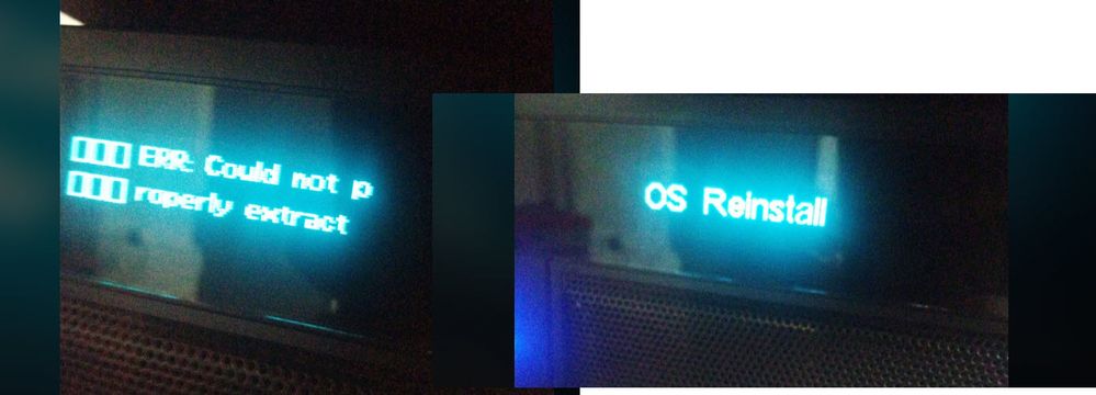

- exibarMay 20, 2022Aspirant
so the attached pictures are what he is seeing upon boot.
is this unit total trashed and not worth it at all?
- StephenBMay 21, 2022Guru - Experienced User
If the firmware image is simply corrupted for some reason, then a USB recovery could resolve the problem. But if the flash memory has failed, then it is not repairable (since it is soldered on to the system board).
So there is significant risk that it is bricked - especially if the previous owner has already attempted a USB recovery.
