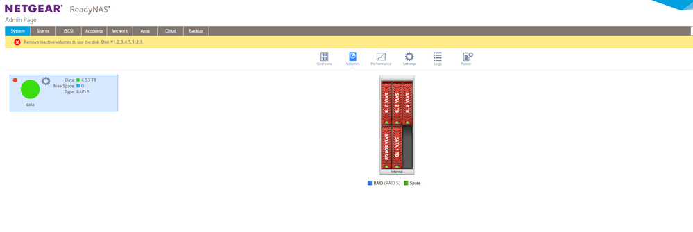

Hello there
today I suddenly lost access to files over the network, and the NAS was totally freezed. so i force rebooted the system and opened admin console. there was message that volume data is in read only mode. one more reboot (from console)(so stupid i know) turned it to inactive volume.
Can i somehow reboot it in read only mode again to save any files?
ReadynasOs 6.10.4

      Stephen, great thanks for replying!
      at the moment I have tried two ways to check disks: using smartctl command via ssh and disk chesk from the boot menu. SMART looks normal with no obvious critical errors. If  it necessary, I can send a report. Also i found some errors in dmesg.log
