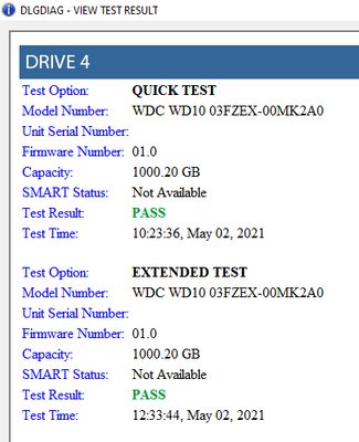

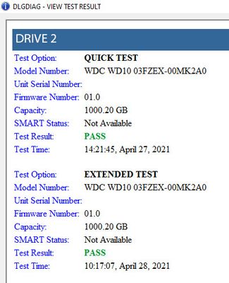

- khushaimMay 03, 2021Aspirant
Drive 1 - Seagate - When I connect it with system, there is no sound of detection (when you connect any device to USB ports, there is a ding-ding sound, something like that) from the system. And SeaTools doesn't detect it as well, and it is not appearing in Disk Management.
Drive 2, 3, and 4 - WD - Detected and I ran the tests using WD Lifegaurd Tools. Please see screenshots below.
When I connect all 4 drives to the Netgear, in netgear panel, only Drive 2 and Drive 3 marked as green checkpoint (small circle), the Drive 1 and Drive 4 has grey checkpoint (small circle).
What do you suggest?
