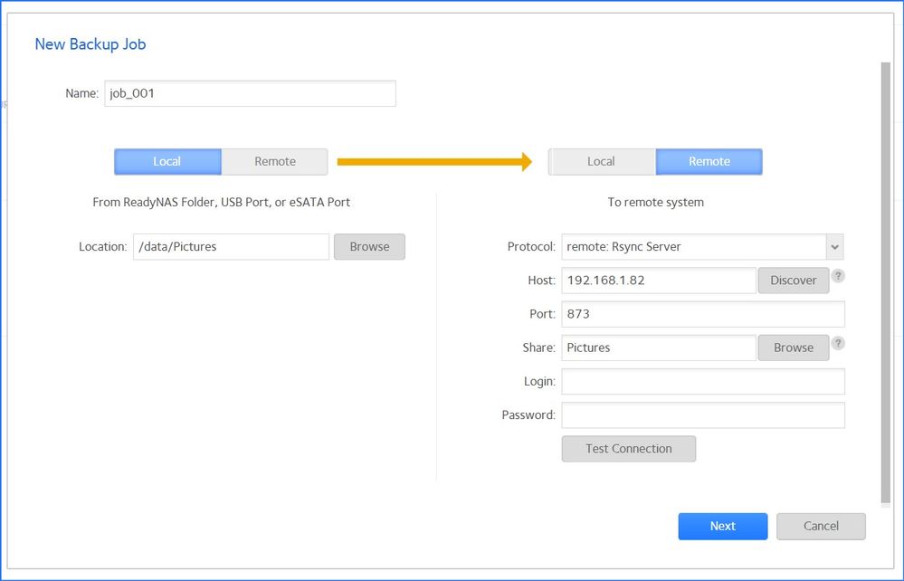

Trying to execute a backup from the Pictures share of RN528X to the Pictures share of the RN212.
Rsync is enabled in the system settings, and Rsync is enabled specifically on the Pictures folders of both NAS's as well (right click on Pictures folder, select Settings, click on Network tab, make sure Rsync is ON and Read/Write is selected).

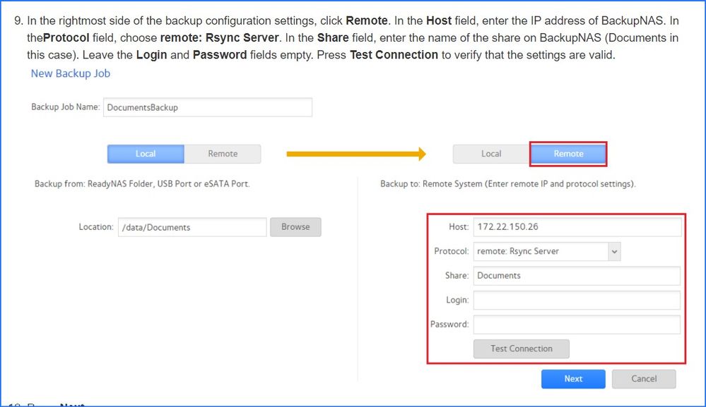

I'm following the NTGR instructions to a tee:
- Select the Local Source share: Pictures
- Select the Remote Destination share: Pictures
- Choose "remote: Rsync Server"
- Auto-populates Port 873
- Leave username/password blank (both drives are on same home network and both are fully accessible via Windows Explorer)

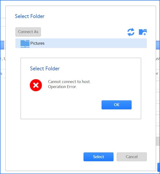

When I click "Browse" to choose the Destination Folder, only "Pictures" shows up. When I double-click it to expand it (has a little triangle to the left of the Pictures icon, indicating there are subfolders), I get an error message "Cannot connect to Host. Operation error."

Is it not allowed to backup directly from one share to another share of the same name? I don't get it, at all. In the NTGR documentation they backup from "Documents" to "Documents", so what is the deal? Really frustrating.
