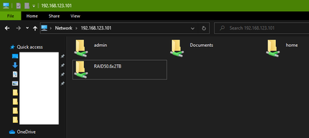

ReadyNAS 516 v. 6.10.7 (I did upgrade in this troubleshooting process but previously was on 6.10.6) I access my ReadyNAS via SMB via \\192.168.123.101 in the address bar. From another Windows 10 ...

nickjames wrote:
When I access my ReadyNAS as I normally would from another Windows 10 machine in my environment, I'm only able to see the Documents share because it's not hidden (expected) but where are the other shares from the previous screen shot?
The first machine is using the NAS admin credentials. That allows it to see the private "admin" folder, but also gives access to the data volume and home.
The second machine is not using the NAS admin credentials, so it doesn't see that stuff. Likely it using anonymous access (since there is no private folder for a NAS account in the list).
There is nothing wrong here as far as the shares you see. If there is stuff in the root that you aren't able to reach from the second machine, then there is some work you should to to put that stuff into share(s).
You can either make the first machine's access the same as the second, or you can make the second machine's access the same as fhe first. If you have a habit a creating folders directly on the NAS data volume from windows, you would be better off making the first machine match the second. That will prevent you from doing that.
Either way, the trick is to use windows credential manager, and look at the username/password for the NAS credetntials.

- StephenBJul 20, 2022Guru - Experienced User
nickjames wrote:
You are right -- there are two accounts in use: admin and Nick. They are both admin accounts but nonetheless, different accounts. I *think* I mapped the drive with the Nick account. That could be what is cached but where is it cached?
They might be both in the admin group, but full access to the data volume is limited to the actual admin account.
Try going into "home" on the machine using the admin account. See if there is a Nick folder in there.
nickjames wrote:
I went through and deleted everything out of the Windows Credential manager yesterday. There was nothing in there that had anything to do with the NAS.
Rather surprising, but possible if you never allowed the PC to save the credentials.
nickjames wrote:
If I reboot my machine, I should always get prompted with username/password for when accessing the share, ie: \\192.168.123.101. It's no longer doing that. It just auto logs me into the share. I think it had something to do with the mapped drive but I can't even see that anymore. Are those credentials saved in the registry my chance?
They are saved by the Windows Credential Manager.
nickjames wrote:
How could I work around this? Change the password to the admin account to force an authentication error? Change the IP address of the ReadyNAS? This is a home environment with only one user (me).
The first thing to make sure that is the NAS shares are set NOT to allow allow anonymous access to the share (click on the share settings wheel in the admin web ui, then Network Access).
Changing account passwords should also help..
But from your symptoms, I am thinking that you should double check the Credential Manager. Make sure you are looking at Windows Credentials. Here's one from one of my PCs - the only windows credentials stored are for the NAS (one using its name, the other using its IP address).
It's worth double-checkidng the "Generic Credentials" section also, as there can be a set of credentials in there also.
