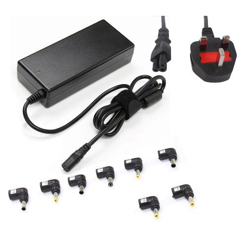

When it comes to the tip size, some generic transformers come with changeable tips. Some even do reversible polarity.
This sort of thing:
Generic adapter
- StephenBMar 04, 2024Guru - Experienced User
Personally, I'm not a big fan of the changeable tip concept for a ReadyNAS.
FWIW, if you just search for ReadyNAS duo power adapter, you'll find a number of power bricks that claim they are compatible. While there might be some mis-information, I haven't seen posts here where that's been an issue.
