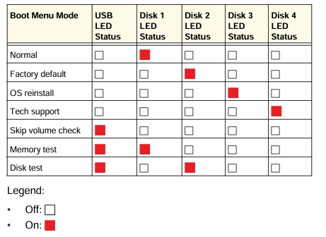

Point 4 on page 13 mentions...
Continue to press the Reset button until all the LEDS except the disk activity LED illuminate.
So its not clear what is meant here as in the about the disk activity.
Questions:
- Do I need to have this exact pattern of lights?
- You mentioned resetting the admin password. Do I do this using the app Raidar?
In the table with
- SandsharkDec 04, 2024Sensei
The LED's are clearly identified in the manual: https://www.readynas.com/download/documentation/UM/ReadyNAS2100_UMv1.1_22Jun09.pdf
The OS re-install does the password reset, you don't do it separately.
