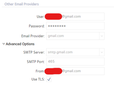

      And just to confirm, after signing in with your Google account, is the screenshot provided below the same as yours?

      • SLK-Purdue's avatar
        SLK-Purdue
        Luminary
        When I try "Sign in with Google", I get a pop-up that says "Redirecting.  Please wait ..."  that eventually times out with the error message I sent.   Just for fun, I did a reboot and tried Edge browser (had been using Chrome).   Got same results.  Odd ....
