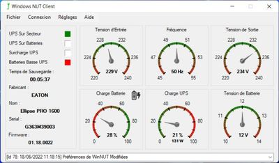

This allows basic control of when the PC shuts down, and also has a graphical display of a bunch of power & UPS related parameters.

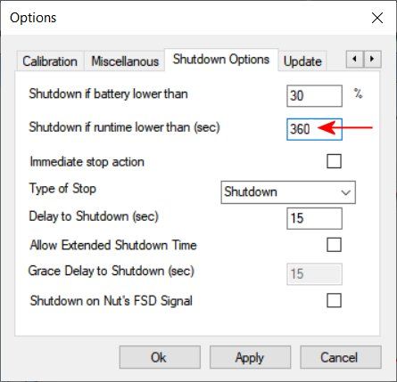

    The only other important settings I changed were the Shutdown Options:
    The default shutdown runtime was set to 120 seconds.  If the NAS shuts down at 5 minutes remaining runtime, that will be a problem.  I set the PC shutdown time to 6 minutes so it will shut down first.  Without that load, the run time should jump way up, and the NAS will run a lot longer.

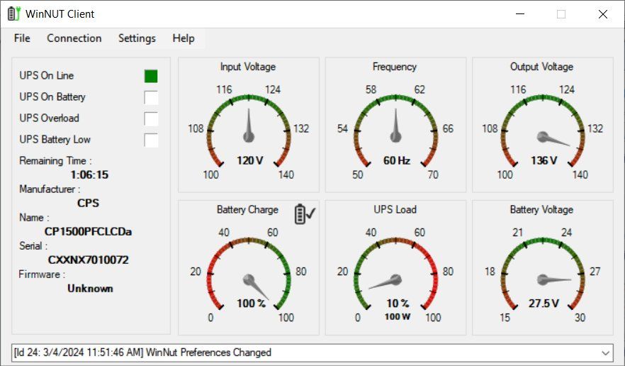

    Note that the nice display you pictured is what you get when a UPS is directly attached to the PC, not when monitoring a remote UPS.

      Actually, that display IS from the UPS via the NAS connected to my PC.  The WinNUT Client gets the info on the UPS from the NAS, and produces that nice display, mimicking what a direct UPS to PC monitor program looks like.
      It's all very slick, once I got the right version.

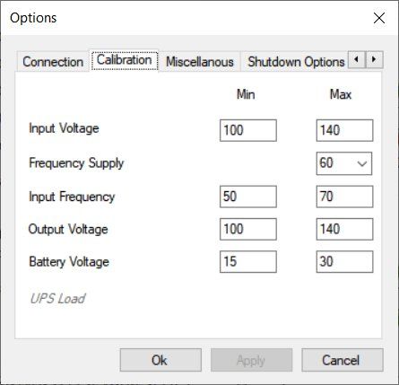

        I noticed that the voltage and frequency "gauges" in the display were wrong, and clearly set for European grid parameters.  To fix this for US power, you have to go to the "Calibration" tab in the Settings.  I have mine configured as shown below:
        Now, my "meter panel" looks like:
        The only thing that is out of whack is that the output voltage is showing 136V, which is WAY too high.  The front panel of the UPS reports 121Vac output.  I'm not sure if the UPS is telling the NAS the wrong value, if the NAS is misinterpreting the info from the UPS, or if the WinNUT program is misinterpreting what it is getting from the NAS...
        I'll report back if I find a fix.
