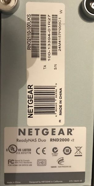

What Ready Nas
I picked up this readynas duo from a friend who owed me some money. I was going to drop it on ebay after testing it but I have had nothing but issues with it. I dropped a drive in it and waited for...

ok, next question is am I stuck at firmware version 4 with no samba v2/3 ?

OK ... A update incase anyone else can make use of this :
I hit google and found the add-ons you mentioned here
Then I used putty and logged in and found the samba file at : /etc/samba/smb.conf
I tried to use nano to edit it to find it was not installed so I had to use vi and I needed google to remember the commands for editing, save and exit. Anyway I added the lines :
min protocol = SMB2
max protocol = SMB2
at the end of the [global] section.
I then rebooted the system and mapped the network drive in windows 10 at the command line :
net use t: \\192.168.1.115\Share /user:admin Pa55W0rd
and bam! All working ...
I then done a few tests and got an average of 9.3MB upload to the NAS and 11.3MB download (nothing on my DS1812+)
So .. The box does work ... Thanks for the push in the right direction, I didnt know the box was over 6 years old.
