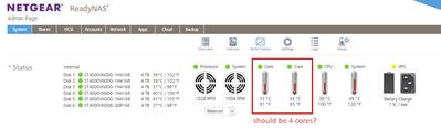

Would this type heatsink/fan be suitable for a Readynas Pro 6 (newest version) running OS 6 ?
Hey guys I have already modded my RNDP6000 with Ram, CPU and PSU but I'm now working on changing the CPU fan as I'm not happy with the only temporarily installed and very basic 'Coolmaster' fan. ...

Also, is there any way to get Frontview to show all 4 core temps, instead of just the 2 it presently shows ?

As for the additional core temperatures, take a look at /etc/frontview/sensors/NV6.conf (which is the target for the symbolic link at /etc/sensors.d/system.conf) and try turning on other temps using the same method as temp2 in the "coretemp-isa-0000" section.
- xlr8rSep 09, 2024Luminary
ah cool... (pun intended 😋)
This is my NV6.conf file contents; what do I change/add ? , and do i need to do anything with the symbolic link at, /etc/sensors.d/system.conf ?
thanks
chip "coretemp-isa-0000"label temp2 "CPU"compute temp2 @%35, @%35ignore temp3chip "w83627dhg-isa-*"label in1 "DDB18"set in1_min 1.62set in1_max 1.98label in2 "AVCC"set in2_min 3.3 * 0.90set in2_max 3.3 * 1.10label in3 VCC3set in3_min 3.3 * 0.90set in3_max 3.3 * 1.10label in4 VCC1_25set in4_min 1.17set in4_max 1.32label in5 "VCC1_5"set in5_min 1.41set in5_max 1.58label in6 "VCC1_05"set in6_min 0.98set in6_max 1.10set in7_min 3.3 * 0.90set in7_max 3.3 * 1.10set in8_min 3.0 * 0.90set in8_max 3.3 * 1.10label fan1 "System"set fan1_min 600label fan2 "CPU"set fan2_min 150label fan3 "System"set fan3_min 600ignore fan4ignore fan5label temp1 "System"set temp1_max 80ignore temp2ignore temp3ignore cpu0_vidignore intrusion0(here is my "dmidecode" data;) ... not sure why it says i have 4-slots, when i only have 2... ? 😶
- SandsharkSep 10, 2024Sensei
Since I've never had a Pro6 with a quad core processor and have no Pro6 in operation at all at this time, I can't give you specifics. You'll have to experiment. I don't even know what you are seeing right now with that quad-core processor.
But you might want to start by changing the ignore temp3 to this:
label temp3 "CoreX"compute temp3 @%35, @%35Then see what temp1, temp4, etc. do.That @%35 option is non-standard, BTW -- something Netgear apparently added to lm-sensors. But it basically makes the floor of the reading be 35°C, as the internal temperature monitors of CPUs tend to be inaccurate below that threshold.You don't mess with the symbolic link. When you change the target file, the link effectively updates. You may want to keep a copy of the original before you start making changes. You will probably have to at least re-start the readynasd process to see the effect in the GUI, maybe even re-boot. - xlr8rSep 10, 2024Luminary
Thanks,
I made the change but there was no difference to frontview / Performance page ?

but how to I validate the temps shown correlate and are accurate to each core...?
weirdly, at the start before editing NV6.conf, it was like this
label temp2 "CPU"
compute temp2 @%35, @%35but in order to get 4 cores showing , i had to rename it to Core0, is that what im supposed to do ?
Then , by adding in compute temp3,4,5, added extra temps... but i dont know how to validate what i see as fact...?
e.g.
chip "coretemp-isa-0000"label temp2 "Core0" [renamed from 'CPU']compute temp2 @%35, @%35label temp3 "Core1"compute temp3 @%35, @%35label temp4 "Core2"compute temp4 @%35, @%35label temp5 "Core3"compute temp5 @%35, @%35produces this (tested all temps varied by putting fan to "quiet" and making Plex transcode...) - xlr8rSep 10, 2024Luminary
must have had some corruption in OS as I have been able to now reinstall perl, and then lm-sensors
i think there is a limitation in lm-sensors for detecting the 4 cores in that one is detected as the CPU, the rest as, Cores...

I mentioned in a post that for testing I was running in "quiet" mode, and transcoding, for the purpose of raising the temps, this was to see if they were all different.
other than putting this in, I cant get the last core to show up...? and i tried all the variants you mentioned...strange
label temp2 "CPU"
e.g.
chip "coretemp-isa-0000"label temp2 "Core0" [renamed from 'CPU']compute temp2 @%35, @%35label temp3 "Core1"compute temp3 @%35, @%35label temp4 "Core2"compute temp4 @%35, @%35label temp5 "Core3"compute temp5 @%35, @%35produces this (tested all temps varied by putting fan to "quiet" and making Plex transcode...)this is what im getting at present with the changes made above....( i tried using compute temp2, temp0, temp5, temp6, but they produced no visible display in the gui...?)

You seem to have skipped temp1. Note that "temp1" in the upper (CPU) section and lower (motherboard) section are independent of each other. AFAIK, you must have something labeled "CPU" for it to include CPU temperature in the fan control. Without it, it will only use the system temp. But I believe you can label something twice (e.g., call temp2 both "Core2" and "CPU").

okay so if this is my current NV6 file, what do i need to add/remove ?
Note: temp1 is in use further down the file contents. this is where im not getting it lol ?
chip "coretemp-isa-0000"label temp2 "CPU"compute temp2 @%35, @%35label temp3 "Core1"compute temp3 @%35, @%35label temp4 "Core2"compute temp4 @%35, @%35label temp5 "Core3"compute temp5 @%35, @%35chip "w83627dhg-isa-*"label in1 "DDB18"set in1_min 1.62set in1_max 1.98label in2 "AVCC"set in2_min 3.3 * 0.90set in2_max 3.3 * 1.10label in3 VCC3set in3_min 3.3 * 0.90set in3_max 3.3 * 1.10label in4 VCC1_25set in4_min 1.17set in4_max 1.32label in5 "VCC1_5"set in5_min 1.41set in5_max 1.58label in6 "VCC1_05"set in6_min 0.98set in6_max 1.10set in7_min 3.3 * 0.90set in7_max 3.3 * 1.10set in8_min 3.0 * 0.90set in8_max 3.3 * 1.10label fan1 "System"set fan1_min 600label fan2 "CPU"set fan2_min 150label fan3 "System"set fan3_min 600ignore fan4ignore fan5label temp1 "System"set temp1_max 80ignore temp2ignore temp3ignore cpu0_vidignore intrusion0 - SandsharkSep 12, 2024Sensei

so after designating 'temp1' as 'Core1'in the upper section and then restarting frontend ;
label temp2 "CPU"
compute temp2 @%35, @%35label temp1 "Core1"
compute temp1 @%35, @%35label temp3 "Core2"
compute temp3 @%35, @%35label temp4 "Core3"
compute temp4 @%35, @%35label temp5 "Core4"
compute temp5 @%35, @%35I see no change or addition of that label ? What would your suggestion be of, what to try changing next ?
thanks
ps. even when i run 'sensors' in Putty, i get this response; (still no Core1...? so maybe my hypothesis that CPU is actually Core 1 is correct ?)
root@NAS:~# sensors
coretemp-isa-0000
Adapter: ISA adapter
CPU: +36.0°C (high = +84.0°C, crit = +100.0°C)
Core2: +37.0°C (high = +84.0°C, crit = +100.0°C)
Core3: +35.0°C (high = +84.0°C, crit = +100.0°C)
Core4: +35.0°C (high = +84.0°C, crit = +100.0°C)w83627dhg-isa-0a10
Vcore: +1.14 V (min = +0.00 V, max = +1.74 V)
DDB18: +1.77 V (min = +1.62 V, max = +1.98 V)
AVCC: +3.28 V (min = +2.98 V, max = +3.63 V)
VCC3: +3.28 V (min = +2.98 V, max = +3.63 V)
VCC1_25: +1.23 V (min = +1.17 V, max = +1.32 V)
VCC1_5: +1.50 V (min = +1.41 V, max = +1.58 V)
VCC1_05: +1.03 V (min = +0.98 V, max = +1.10 V)
3VSB: +3.28 V (min = +2.98 V, max = +3.63 V)
Vbat: +3.23 V (min = +2.70 V, max = +3.63 V)
System: 1041 RPM (min = 602 RPM, div = 16)
Processor: 958 RPM (min = 602 RPM, div = 16)
System: +45.0°C (high = +80.0°C, hyst = +127.0°C) sensor = thermistor - SandsharkSep 13, 2024Sensei
Note that I cannot see your screen grabs until they are approved. Since you now say nothing changed adding temp1 and I can see the previous screen grab, yes, temp2 is fairly obviously core1. You can just leave it that way or, I believe, you can label it twice, as both CPU and Core1.
