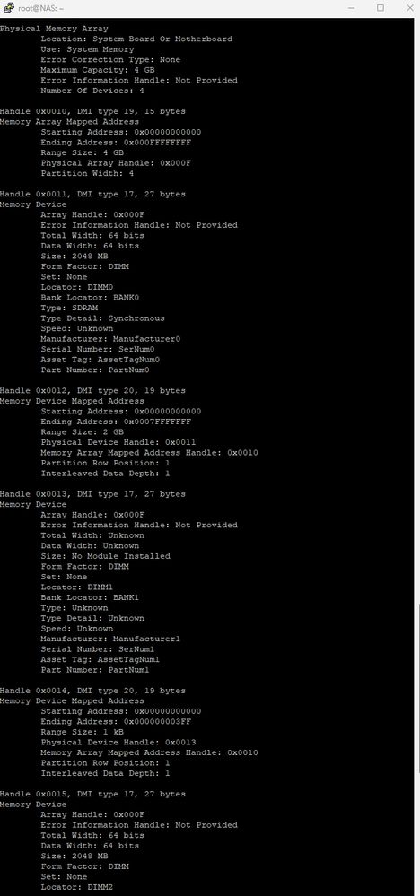

(here is my "dmidecode" data;) ... not sure why it says i have 4-slots, when i only have 2... ? 😶

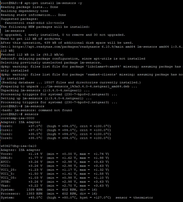

So, as you mentioned 'lm-sensors', i tried to update/install it but got errors....
I ran "apt update"; (some did upgrade, others did not ?)
root@NAS:~# apt upgrade
Reading package lists... Done
Building dependency tree
Reading state information... Done
Calculating upgrade... Done
The following NEW packages will be installed:
keyutils libmnl0 libncurses6 libpcre2-8-0 libreadline8 libtinfo6 libunistring2 pci.ids xxd
The following packages have been kept back:
bind9-host ca-certificates cryptsetup-bin dash dconf-cli dpkg glib-networking-common kmod libarchive13 libasound2-data libbind9-90 libconfuse-common libdbus-1-3 libdns100 libisc95 libisccfg90 libkmod2 liblwres90 libvorbisfile3 libwrap0 login lsyncd mime-support ncurses-base nfs-kernel-server ntpdate openssl passwd rpcbind samba-common udhcpc
The following packages will be upgraded:
acl adduser attr base-files base-passwd debconf debconf-i18n debian-archive-keyring debianutils diffutils dmidecode dosfstools etherwake ethtool findutils grep gsettings-desktop-schemas gzip hdparm hostname init-system-helpers initscripts inotify-tools insserv libacl1 libattr1 libbz2-1.0 libcap2 libcap2-bin libcsv3 libdaemon0 libdb5.3 libdebconfclient0
libedit2 libenca0 libexiv2-13 libgcrypt20 libgeoip1 libgmp10 libgpg-error0 libgsf-1-common libicu52 libid3tag0 libidn11 libidn2-0 libinotifytools0 libisccc90 libjbig0 libjson-glib-1.0-common libkeyutils1 liblua5.1-0
liblua5.2-0 liblzma5 liblzo2-2 libmspack0 libmxml1 libncurses5 libncursesw5 libnfnetlink0 libnfsidmap2 libnss-mdns libntlm0 libogg0 libpci3 libpcre3 libprotobuf-c1 libsasl2-2 libsasl2-modules-db libselinux1 libsemanage-common
libsemanage1 libsepol1 libstemmer0d libsubunit0 libtasn1-6 libtext-wrapi18n-perl libtinfo5 libtirpc1 libunwind8 libusb-1.0-0 libustr-1.0-1 lsb-base lua5.1 lzop makedev ncftp ncurses-bin net-tools netbase readline-common sed sensible-utils shared-mime-info startpar sysv-rc sysvinit-utils ttf-bitstream-vera tzdata ucf vim-common vim-tiny xz-utils zip zlib1g
104 upgraded, 9 newly installed, 0 to remove and 31 not upgraded.
Need to get 23.5 MB of archives.
After this operation, 12.8 MB of additional disk space will be used.
Do you want to continue? [Y/n] yThen I tried to install 'lm-sensors' (didnt work?)
root@NAS:~# apt-get install lm-sensors -y
Some packages could not be installed. This may mean that you have
requested an impossible situation or if you are using the unstable
distribution that some required packages have not yet been created
or been moved out of Incoming.
The following information may help to resolve the situation:The following packages have unmet dependencies:
lm-sensors : Depends: perl:any
E: Unable to correct problems, you have held broken packages.SO, i then tried to install 'perl' (didnt work?)

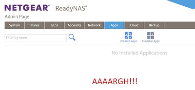

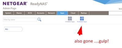

aw crap!
whatever i did there has removed my installed Apps and also removed all Available apps ...
anything simple I can do to restore these ? (im currently on OS 10.6.9) and have it saved as a .deb file. Is there a Putty command i can reinstall it with ?
thanks
- xlr8rSep 10, 2024Luminary
ah...fixed it , must have made a mistake in sources

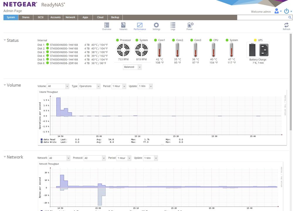

thanks

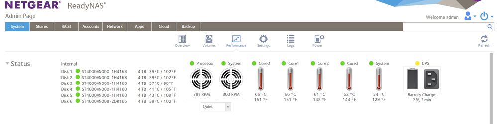

maybe getting somewhere...
but how to I validate the temps shown correlate and are accurate to each core...?
weirdly, at the start before editing NV6.conf, it was like this
chip "coretemp-isa-0000"
label temp2 "CPU"
compute temp2 @%35, @%35but in order to get 4 cores showing , i had to rename it to Core0, is that what im supposed to do ?
Then , by adding in compute temp3,4,5, added extra temps... but i dont know how to validate what i see as fact...?
e.g.
chip "coretemp-isa-0000"label temp2 "Core0" [renamed from 'CPU']compute temp2 @%35, @%35label temp3 "Core1"compute temp3 @%35, @%35label temp4 "Core2"compute temp4 @%35, @%35label temp5 "Core3"compute temp5 @%35, @%35produces this (tested all temps varied by putting fan to "quiet" and making Plex transcode...) - xlr8rSep 10, 2024Luminary
must have had some corruption in OS as I have been able to now reinstall perl, and then lm-sensors
i think there is a limitation in lm-sensors for detecting the 4 cores in that one is detected as the CPU, the rest as, Cores...
- SandsharkSep 11, 2024Sensei
LM-sensors is completely capable of detecting 4 (and even 😎 cores with a proper .conf file. But in order for the fan speed to be properly controlled by the ReadyNASOS, you need to have one of them labeled "CPU" in the .conf file so as to be matched with the fan labeled "CPU" in the lower section. AFAIK, you can have one with two separate labels.
As for how to verify the displayed values, I have no idea. I think you have to trust the folks who wrote lm-sensors know what they're doing.
You say you did an apt-get update, but the results you posted are for an apt-get upgrade, which was a really bad idea. Some of the Netgear-specific executables rely on a specific version of a package, and Netgear has even modified some packages (such as lm-sensors). Replacing some of them with more recent standard Debian versions, as an apt-get upgrade will do, can create problems.
A customized version of lm-sensors was already installed, and you have overwritten it. You are now 100% on your own as to how to figure out how to insure the fan speed will be properly controlled WRT temperatures. I have no idea if what i said in the first paragraph is still true with the updated lm-sensors you installed. The picture you posted shows some pretty high CPU and System temperatures and very low fan speeds, so it seems that the control is not working properly.

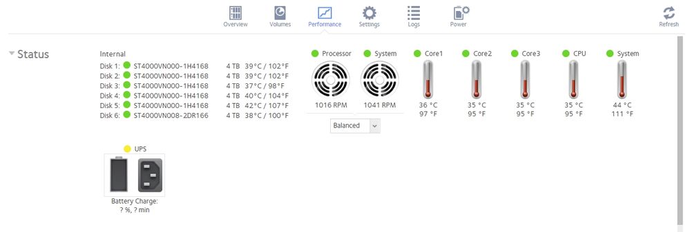

- xlr8rSep 11, 2024Luminary
Hi
my NAS is fully operational despite the upgrades... it was touch and go for a few mins, but it rectified itself....
i think there was 100+ updates done lol, but everything still works.
I mentioned in a post that for testing I was running in "quiet" mode, and transcoding, for the purpose of raising the temps, this was to see if they were all different.
other than putting this in, I cant get the last core to show up...? and i tried all the variants you mentioned...strange

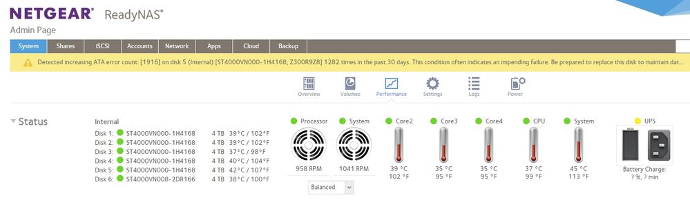

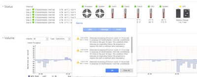

also, just noticed one of my disks is about to implode... I wasnt getting this error before i did the "upgrades/Updates"... so ive either fixed disk checking, or broken it lol
You seem to have skipped temp1. Note that "temp1" in the upper (CPU) section and lower (motherboard) section are independent of each other. AFAIK, you must have something labeled "CPU" for it to include CPU temperature in the fan control. Without it, it will only use the system temp. But I believe you can label something twice (e.g., call temp2 both "Core2" and "CPU").
I doubt anything you've done has caused the ATA errors. It was just a matter of time before it happened. Note, however, that that's one SMART parameter that can be false in that the chassis SATA system can be at fault instead of the drive.

CPU: +36.0°C (high = +84.0°C, crit = +100.0°C)
Core2: +37.0°C (high = +84.0°C, crit = +100.0°C)
Core3: +35.0°C (high = +84.0°C, crit = +100.0°C)
Core4: +35.0°C (high = +84.0°C, crit = +100.0°C)w83627dhg-isa-0a10
Adapter: ISA adapter
Vcore: +1.14 V (min = +0.00 V, max = +1.74 V)
DDB18: +1.77 V (min = +1.62 V, max = +1.98 V)
AVCC: +3.28 V (min = +2.98 V, max = +3.63 V)
VCC3: +3.28 V (min = +2.98 V, max = +3.63 V)
VCC1_25: +1.23 V (min = +1.17 V, max = +1.32 V)
VCC1_5: +1.50 V (min = +1.41 V, max = +1.58 V)
VCC1_05: +1.03 V (min = +0.98 V, max = +1.10 V)
3VSB: +3.28 V (min = +2.98 V, max = +3.63 V)
Vbat: +3.23 V (min = +2.70 V, max = +3.63 V)
System: 1041 RPM (min = 602 RPM, div = 16)
Processor: 958 RPM (min = 602 RPM, div = 16)
System: +45.0°C (high = +80.0°C, hyst = +127.0°C) sensor = thermistor - SandsharkSep 13, 2024Sensei
Note that I cannot see your screen grabs until they are approved. Since you now say nothing changed adding temp1 and I can see the previous screen grab, yes, temp2 is fairly obviously core1. You can just leave it that way or, I believe, you can label it twice, as both CPU and Core1.
