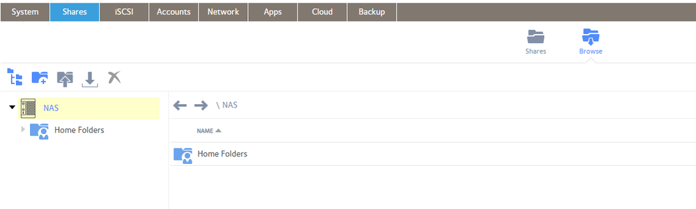

This is all that I see when trying to browse folders:

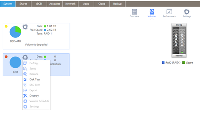

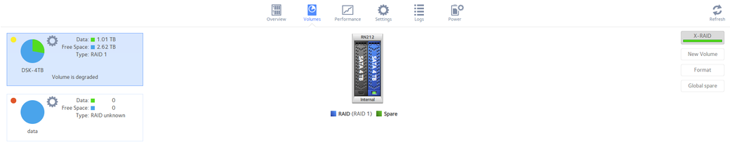

If I select Drive#1 I see the X-Raid in green, New Volume greyed out and Format and Global Spare are available.
Should l eliminate/destroy that "data" volume that is showing up there with 0 for Data and 0 for Free Space?

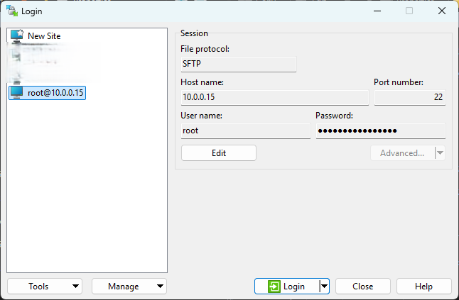

    If you are still using password as the NAS admin password, then change that to something.  Then double-check that ssh is still enabled in system->settings->services->ssh.
    You can then download WinSCP ( https://winscp.net/eng/index.php ).  That supports a protocol called SFTP.  Set up a connection that uses that protocol.
    Use the IP address of your Nas (not the one in the screen shot).

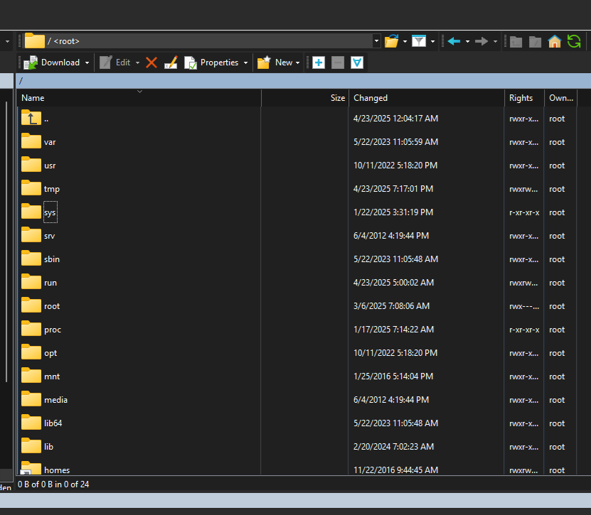

    After you connect, the right pane should look something like this:
    Somewhere in that list you should see your DSK-4TB folder.  Navigate into it, and see if your shares are listed.  If they are, you can copy them to a disk on the PC.

  • UPDATE: The "data" volume showing there is the volume of the 6TB drive (JBOD) that is not mounted. Could it be that since I had Drive#1 and then inserted Drive#2 maybe I named them both the same and screwed that?
    No.  Doing that will make it even more difficult to recover.
