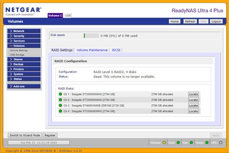

X-RAID2 "Dead", even though still fully-accessible
I have a ReadyNAS Ultra 4 Plus that I use primarily for storing music. It has four Seagate IronWolf drives (3x3TB + 1x4TB) that show green buttons. The volume is also completely accessible, readabl...

I had a NAS that did that, and I found it was because some of the drives were slower to spin up than others. But I had a 3 + 3 of two drive types, and you have but one that's differtent. And it also typically "kicked out" one of the drives from the volume. I think there is some kind of bug that causes a volume to be marked dead, even for a temporary condition, the NAS still reports it is, though it isn't any longer.
BTW, I upgraded that NAS top OS6 abnd the problem went away. Given other issues are begining to arise due to the age of OS4.x and specific protocols being removed from PC's, you may want to consider upgrading to OS6 before the next shoe falls.
