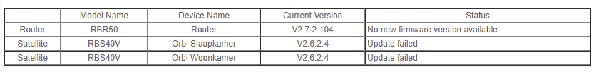

  • ​Hello,
    Since two days I ​am having​ same problem with both of my RBS40V devices. Yesterday I resettet both devices and added them again to the router (RBR50) The problem seemed solved, but just now one of the RBS40V's again gives problems (connected but no internet)
    In my router I see at "Firmware update" for both devices at first "Downloading firmware" and then "Update failed"
    ​I also tried manually updating the firmware. The latest version I can find on the site is V2.6.2.4_1.0.1. (I don't know if this one is newer then my V2.6.2.4). But when I unzip this download it contains a ".chk" file (tried multiple times to download) and when I try to upload it to the router it says it is expecting a ".img" file.
    Can anyone help me out. It is quite frustrating that my devices are losing internet connection (some devices depend on it). For such an expensive setup I expect better.
    Thanks,
    Wilco

      CoonHouse wrote:
      ​Hello,
      Thanks,
      Wilco
      I get the same thing (a .chk file) when downloading the firmware from the support web site. I think it is glitch in the Netgear servers.
      Consider starting a new thread with a title like "Cannot update RBS40V firmware".  Many people don't read an older thread.
