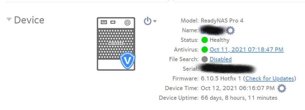

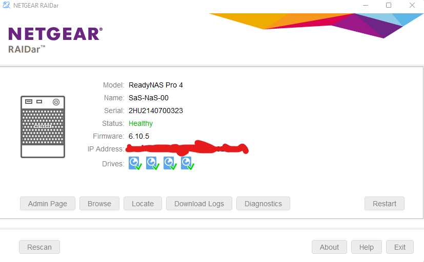

I own a ReadyNas pro 4 can it be updated to OS6.0?
Hi I have updated the memory to 2 GB  and disks on this old pro 4 it works ok
I wanted to know if the OS can be updated and how to (valid links for bin files) and process (or in alternative if anyone could point to a service that does this update)
