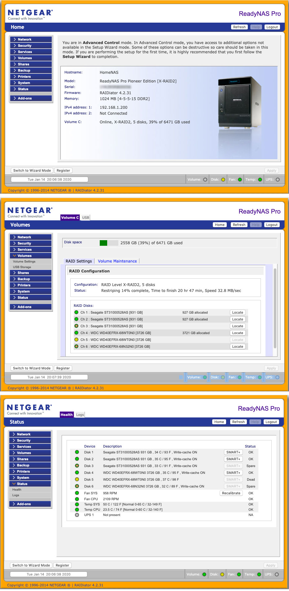

Thanks again Stephen!
Acutally, just for giggles, I put in a NEW 4TB red drive where I previously had that 3TB drive (in bay 6... now it says it's restriping... 14% done now.. probably take another day or two to finish. Do you think it's possibly restriping anything useful? Or is it just restriping junk. You alluded to needing to know what capacity drives did what in a RAID.. I obviously do not :) - but I am sort of hoping/thinking that that 4TB drive will now allow the volumes to restripe/re-mount? Or is that a fools dream??? Screen shots attached...
