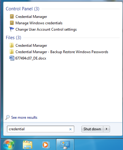

“It is there on my PC, and it opens the Windows Credential Manager. So you could look in there directly. “Could U send a screendump of this button? What is your version of W7 called ?
Ntgr referrs to a tool for password questions (Mother's bithplace etc) but the webpage is empty. Any way to get that tool?
- StephenBJun 27, 2021Guru - Experienced User
SUB-conscious wrote:
StephenB Guru said: “It is there on my PC, and it opens the Windows Credential Manager. So you could look in there directly. “
I'm no longer running W7. To access the credential manager directly, open the start menu and type "credential" in its search box. The, click the Credential Manager (the top one in the screen shot below)
You can also get there by opening the control panel, and then selecting User Accounts (and Family Safety) -> Credential Manager.
W7 doesn't store web passwords in the credential manager (newer versions of Windows do), but you still might see the NAS password in the Windows Credentials section or the Generic Credentials section.
