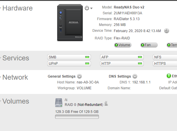

Both HDD's are detected correctly.After reseting my ReadyNas to Factory Settings I can see information "Booting" then "Testing Discs" then "Click Setup" in RAIDar 4.3.8 software. Both LED lights are on in Software - RADIar 4.3.8. and on the housing of RadyNas Duo V2.I am clickin "setup" and choosing "Flexible Volume (Flex-RAID)". From drop down menu "Select the desired RAID level" I am choosing 0 then "Create volume now".
After finish I am opening IP address of my RadyNas in browser and capacity of volume RAID 0 is 1.8TB.
So in my opinion there can be problem with compatibility of my HDDs - I have got 2 x WD20EURX (2TB each) or can be problem with ReadyNas Duo V2 Firmware (my RAIDar is showing 5.3.13 firmware version) or this is normally impossible to do that.

Have you tried erasing the volume and then running the wizard again? Have you tried reinstalling RAIDar? We tried what you did on RAIDar 4.3.8 and we got it to do RAID0 on Flex-RAID using 80GB and a 250GB HDD.
I don't think it has to do with HDDs you have as well unless you really have a bad disk. Were the HDDs used on a NAS before? You may want to try doing erase volume first then redo setup.
You may also want to try another disk to make confirm if you have a bad one.
