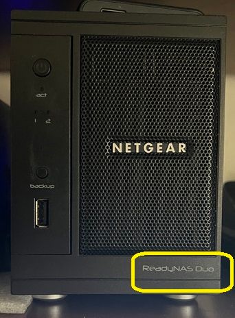

I'm sure the Guru's will be along soon. Meanwhile a few questions.
Are you sure it's a V2? Check the labeling on the front door. If it just says Duo, it's a V1 despite what other labeling says. See pic below.
Are you able to still access your data on the remaining drive? If so, I would recommend backing up your stuff before attempting any repairs. I would also not shut it down until everything's backed up.

Not sure how I missed Sandshark's reply. He nailed it.
- SandsharkSensei
You missed it because I was in mid-reply when you posted yours. With details like this, I take my time to insure I got everything right and complete. But your picture was helpful, thanks for posting.

Hi guys I appreciate the prompt and informative reply's. It is v1, it doesn't have the v2/Duo on the front sadly. I forgot to mention id already powered it down because i wasnt sure if it was hot swappable or not. I took the drives out in the hope i could read them. Ive inserted the good drive, rebooted and can now see the files on it, which is a start. As advised im going to backup the more important files etc before i insert the replacement drive.
