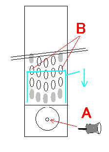

Also noticed taking these out, the release catches dont work anymore, the caddies are getting harder and harder to remove. one is harder to insert to, but i can see no obstructions.
The Duo's trays can be hard to remove. There are two options.
The first is to insert a push pin in the center of the circular release button ("A" in the diagram). While some have had success with that method, it hasn't worked well for me.
The second is to insert a small screwdriver (or maybe an unbent paper clip) through the hole at one of the two points labeled "B". Pull it downwards toward the release button. This releases the latch mechanism, and is the method I use.
I don't know what you can do to deal with your insertion problem.
There are still some replacement trays for sale on ebay and similar sites. There is a newer tray that has a square release - that doesn't have the issues the original ones have. But those are quite pricey, so IMO a questionable investment given that we are talking about a ~15 year old NAS.

shawie66 wrote:Also noticed taking these out, the release catches dont work anymore, the caddies are getting harder and harder to remove. one is harder to insert to, but i can see no obstructions.

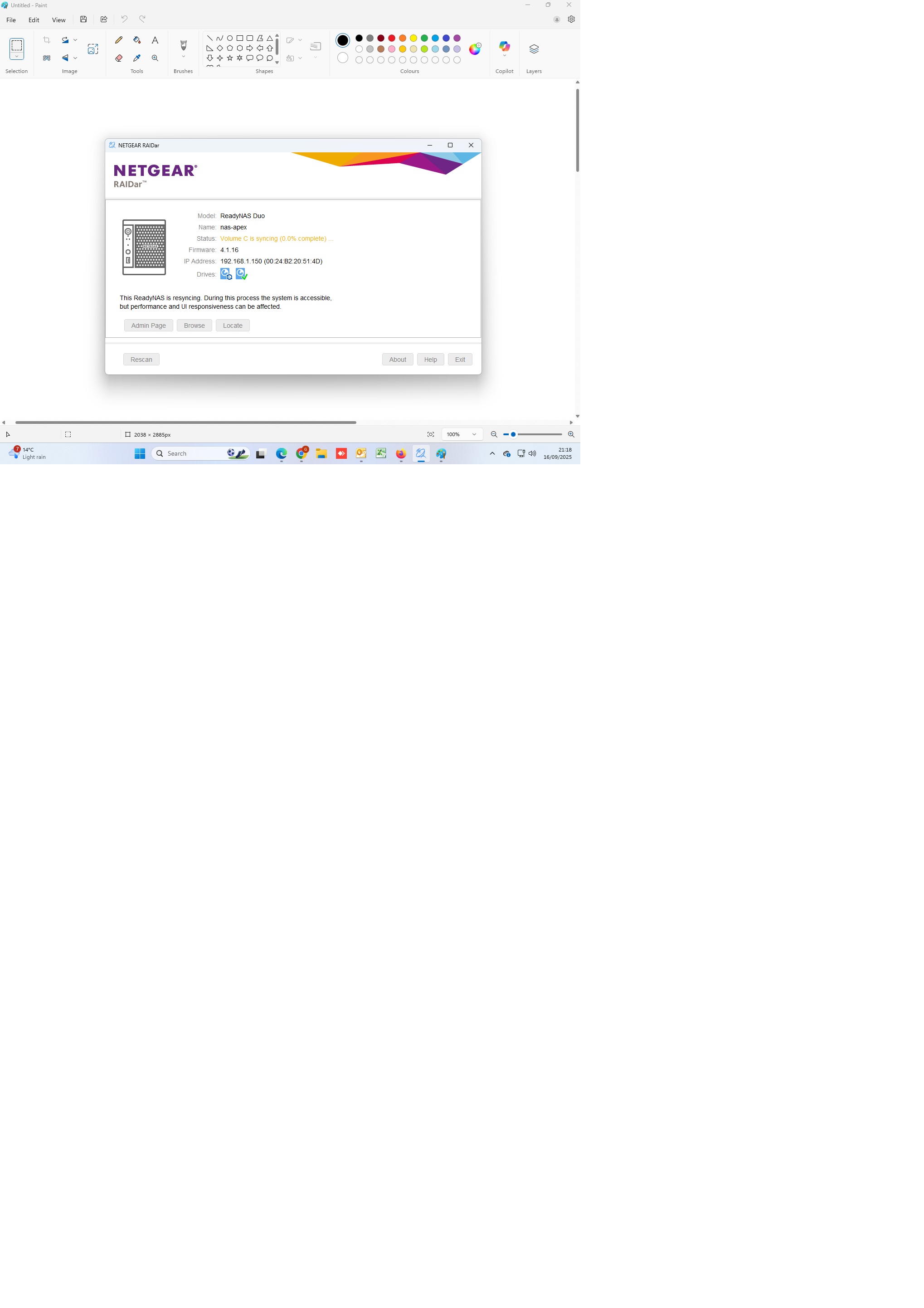

to be honest i cant remeber how they were set up, it was years ago, but id guess with my unfamiliarity with this NAS i would have used the wizard. I know when i first tested the faulty drive it did show the files that were different to the working one. Now the faulty one just doesnt show up, either in windows or using R-linux. i basically removed the disks from the caddies, used a little WD40 and thats made the latches work again! I had to power the unit down (I removed the disk while it was on) because its position is in a cupboard under the stairs with no light.
I then put the working disk in the right hand position (2?) and the new one in 1. They slotted in prefectly. Obviously the unit was powered on at that point. However, thinking i might have a chance now, i ran Raidar but its showing no disks detected, that said all the lights are flashing the power light flashes steadily, the 3 below (disk activity, led disk 1/2) flash twice slowly and 3 times quicker. hopefully that indicates its trying to set up...- StephenBSep 16, 2025Guru - Experienced User

- shawie66Sep 16, 2025Guide
tried the old drive and its not recognising it at all. So i put the 'working' one in and checked. everything seemed ok, it recognised the drive, i can access it without problems. So i put new replacement drive in after and it seems to have recognised that one too and it says it resyncing. so fingers crossed !
