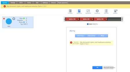

2120 - after freeze and reboot all volumes are lost
I've got huge problem with netgear - after a freeze i made a reboot. Then there are no volumes, all data is inaccessible. Screenshot below. Could you please tell me how to restore my data? it's...

pyby wrote:
There's no option to boot nas in read only mode?
There is, but that only helps if the volume(s) can be mounted. So it won't be useful.
Support can isolate it more quickly, though there is some likelihood that you will need a data recovery contract to get the data back. Is the data backed up?
