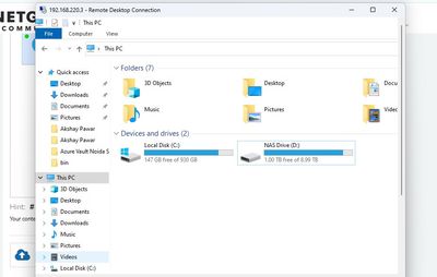

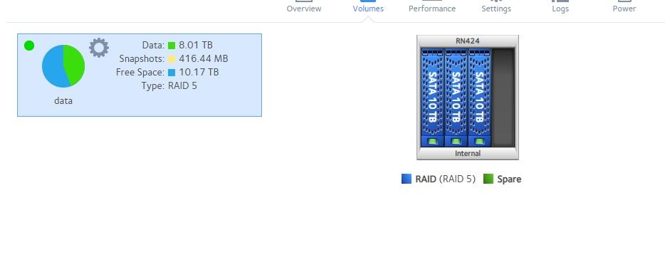

- RAJIVAVLINQJun 17, 2024Aspirant
Thank you for you quick response.
Disk is added but it is showing unallocated space, how to allocate this space to my Drive.
