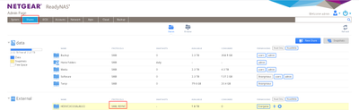

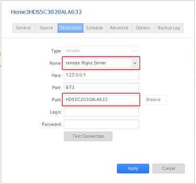

      OK, come to think of it and to avoid trouble in the future... Please apologize, if the follwing is a potentially stupid question:
      Assume, I want to backup a couple shares to an external USB drive connected to the ReadyNAS. I want to use rsync, because that allows hassle free incremental updates. So I connect the drive, enable RSYNC R/W access for that drive in the admin page share section like this:
      Now assume, I want to create a backup job for all home shares like this:
      As destination, I point the NAS to the remote rsync server on 127.0.0.1 (which is essentially the local machine accessing the USB drive via rsync):
      I exclude the /admin/snapshot directory, because this will confuse the NTFS filesystem and set the --delete option to remove remote files that don't exist locally anymore:
      So far, so good.
      This backup seems to be bound to the share HDS5C3020ALA632 for the destination. Now assume, that drive is not connected but I accidentially hit the backup button on the NAS. I hope, in this case it is NOT writing to the OS partition but rather failing the operation in the first place as any sane person (and all the Linux OSes I have worked with) would do.
      Am I right? Thanks again for your patience. I'm getting a bit paranoid after three sleepless nights. :smileywink:
      P.S.: I hope the screenshots show up in my post. I can see them while editing but after posting, there's just the yellow triangle...

        I've not tried it, but I think the answer may be that it will write to the OS partition in that case.  I know rsync can't tell the difference when a directory that's intended as a mount point actually has something mounted to it or doesn't, but does somehting in the NAS unique software check first?
        The screen grabs are there.  A moderator has to approve them, but that's obviously already taken place.
        I think this is worth some time with my "sandbox" NAS, so I'll give it a try some time this weekend if I have the time.  You may have more fully explained why so many have issues with a too full OS partition.  We've seen instances that were clearly related to an unmounted USB drive, but I never thought about the backup button being a trigger.
        Or, if you want to try it, do so with a share that has very little in it, so the OS partition won't fill and you can still get in with SSH and check the content of the mount point with nothing mounted and delete anything that is there.
