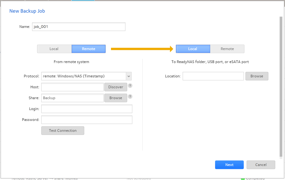

I am creating backup jobs on the ReadyNAS' network/IP interface, to pull files from the Mac to the 424.
Are you using the MacOS admin credentials in the backup job?

whartonw wrote:
I can't see how to tell the NAS to tell the Mac that I am the Mac admin,
Note the login and password fields in the backup job :smileywink:
Those are the login/password the NAS presents to the Mac. They should probably be set to use the Mac admin account.
