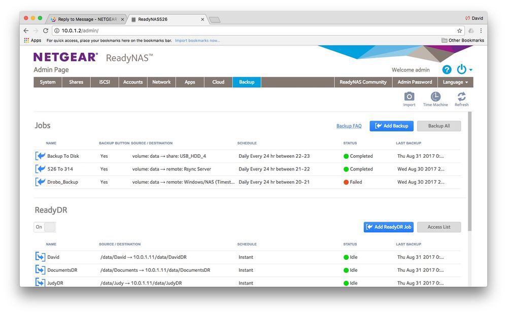

        The backup of the entire data file is being reported as Failed.
        and the backup Log reports the following:
        Backup Job Name: Drobo_Backup
        Backup Job Type: Incremental
        Protocol: cifs
        Backup Source: [volume:data]/
        Backup Destination: [remote:cifs]///10.0.1.3/ReadyNAS526
        Backup Start Time: Wed Aug 30 2017 21:38:37
        Backup Finish Time: Thu Aug 31 2017 0:44:50
        Backup Status: Fail: Failure during copy.
        This is followed by a long list of folders that were unable to be copied during the backup as well as a longer list of the items that were copied.
        If I look at the target device (the Drobo NAS), it appears that all of the ReadyNAS shares, folders and files are there.
        Does that mean that the ReadyNAS is reporting a false failure and the backup is actually completing sussessfully?
