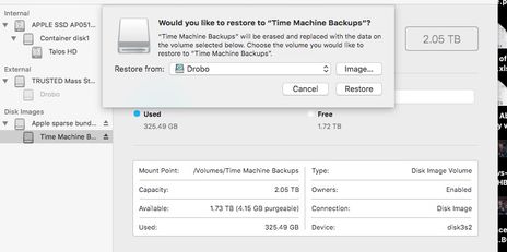

By logging into ReadyNAS as admin over SMB, I can navigate to the appropriate .sparsebundle and mount it. Yesterday I changed ownership of it (previously owned by root), thinking that would help; it is now owned by my laptop's user ID, and permissions to the Backups.backupdb in the attached image are drwxrwxrwx+
From the article you linked, I then tried to Restore (Disk Utility) from Drobo to the mounted "Time Machine Backups". It fails, giving OSStatus error 22, with "could not validate sizes - invalid argument" error. Here's the setup (below).
Alternately, I get OSStatus error 19: "source volume is read-write and cannot be unmounted, so it can't be block copied"
