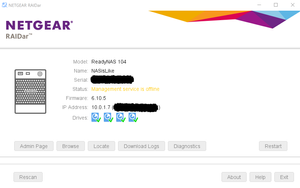

Boot up gets stuck on same file, tried booting into read only and stuck on different file.
Hello. There was an update, then I had a drive fail. I hot swapped it and everything seemed to work fine. Later when the nas shut down it would not boot up again. Raid X Netgear RAIDar shows my...
