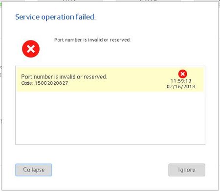

Cannot enable SSH on RN102 w/ 6.9.2
So I bought a used RN102. It came with OS6.0.0, and it went through the update process to 6.2.x, then 6.5.x, then 6.9.2. Only the default options were enabled through that process. I was pleased i...

Guess I should have gone farther in the configuration before posting. I get this message whhenever trying to enable or disable any protoocol. All other changes seem to work fine.

Actually, that would have been me that was unaware, since it had OS6.0.0 when I purchased it and this is my first ARM based OS6 NAS. But it did successfully say it updated to 6.2.x (I didn't pay great attention to the last digit) and then offered to update to 6.5.2, which I did, and then 6.9.2. Oddly, though, the update to 6.2.x is not in the log, which is another reason I cannot precisely identify the version. So, maybe it's related. I have initiated the factory default (which I already thought was my best solution) and will post an update when it completes.
- SandsharkFeb 19, 2018Sensei
Factory default cleared everything up. But not everyone would be happy having to do that.
