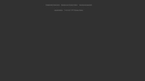

Can't access admin using server name - RN214
Not sure when this changed, but I used to be able to access the admin page using the server name (i.e. myservername/admin). However, it now only presents a footer page. When I access it via IP (10.0....
