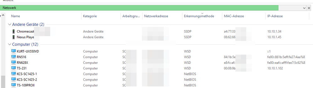

A good indication is Windows Explorer - all WSD announed hosts _must_ show up here, as well the NetBIOS ones (SMB 1.0/CIFS Client feature enabled), and no crappy Internet Security garbage (yes!) blocking things, no network devi es blocking Multicast res. IPv4 boradcasts, you will see something like this:

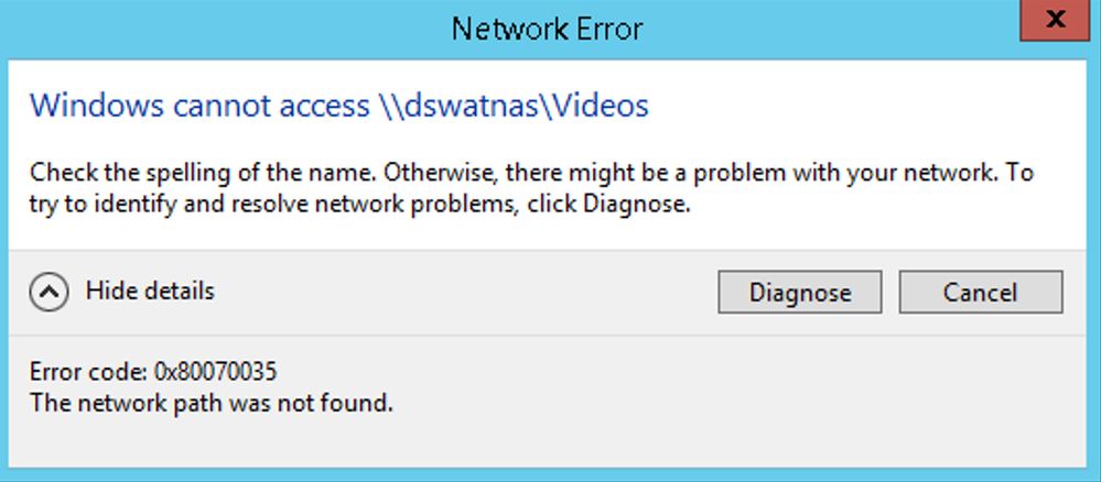

Having the same problem.
After 6.10 it will not connect to it's name after working successfully for a good 5 years. It doesn't appear to be an SMB encryption setting because this still works.
Works from any station:
\\192.168.x.150\Videos
This does not work from anywhere regardless of OS:
\\dswatnas\Videos
- EKroboterMay 01, 2019Apprentice
I was sure it was an upgrade bug. Have you tried changing the name from dswatnas to dswatnas1 and see if you can access it?
- dswhatMay 01, 2019Tutor
JUST about to come back here and report that I did exactly that.
Renamed it to dswatnas01 and restarted SMB....clients can connect now.
I'm gonna try to change it back.
Well, changing it back, broke it again. :-(
We're in the exact same situation. I had to manually add credentials to each PC in order ot be able to access the nas by its original name.
Even when I add credentials is does nothing for me...it will not find the old name on the network. I'm just gonna change it and leave it, I don't have time for this. HA!
