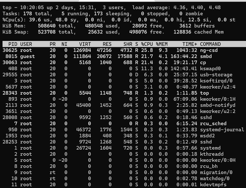

        Actually, I missed the 12% si utilization on the CPU summary in the TOP command pic. So CPU is pegged.

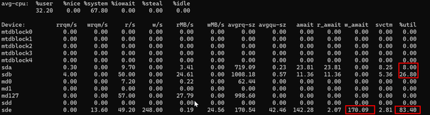

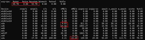

        Another interesting thing I see on IOSTAT output is the %utilization of the read HDDs vs the write SSD and also the WAIT on the SSD?
        The HDDs show pretty low utilization, and it's % util sort of corresponds with the % of actual to rated read speed...what would be holding this back? CPU/Memory is not designed in this such as to take full advantage of these slow HDDs?
        The SSD shows very high utilization when the throughput is way less than capacity. I have no theories as to why this would be. Also note the WAITs for this. No clues on my end.
