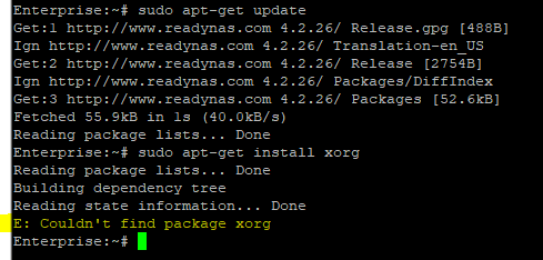

- tony359Apprentice
- CarlEdmanLuminary
AH, that could be a problem! I am running OS 6.9.3, but on ancient hardware: A ReadyNAS Ultra 6 Plus that I bought almost 8 years ago. Never regretted the upgrade to OS 6, but storing all your data off the system while you reformat to OS 6 can be a pain.
FWIW, my /etc/apt/sources.list is:
deb http://apt.readynas.com/packages/readynasos 6.9.3 updates apps main deb http://mirrors.kernel.org/debian jessie main deb http://security.debian.org/ jessie/updates main
