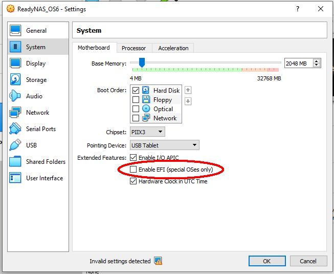

You are using a UEFI boot. It needs to be standard BIOS.

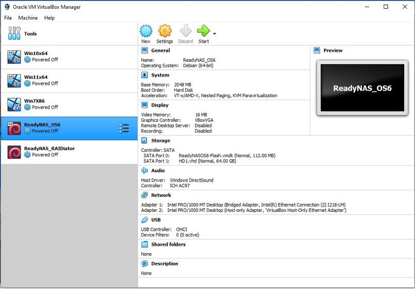

Here is my configuration:

I installed again from scratch and I'm not using UEFI now. I'm attaching screen shots. The screen shots you tried to attach didn't come through, perhaps you could re-upload? I'm also attaching the errors I get as well. Basically I get the:
NMI Watchdog: BUG: soft lockup CPU#0 stuck for 22secs!
Basically, I was sure to UN-check "Enable EFI" in the "System" setting. I also set my data disk to 10GB. All the same result...
I also tried selecting "linux" and "debian 8 jessie" and "Other Liniux 64bit" in "General", all same result.
The screen shots show my VM configs as well as boot errors.
- StephenBMar 12, 2023Guru - Experienced User
You should be able to see Sandshark's images now.
