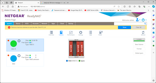

and a degraded message on the display. I suspect the drive had failed (now appears blank and -1rpm in the disk log) because of the stress it got from resyncing. I have a spare available to go in. Made sure all the important data is backed up elsewhere but noting it could just be a dodgy connection, I thought I would power down, remove all drives, get rid of any dust, put them back, power up and insert the new drive. I now get the following screen:
It clearly monitors removal and reinsertion even when switched off! I know the drives are back in the correct order. Is there any easy way to remount the array? I appreciate I might lose some data but anything is better than trying to reload 8+TB. Linux commands are not a problem for me and I have previously ssh'd into it.

      Thanks for the offer but I may not need it. So, this morning I powered it up again to download the logs but this time removed the 'failed' drive before switching on. And it recognised the array straight away, and identified it was back in the degraded state. So, I have put in my spare drive and it is now 8% through a resyncing operation. It appears that powering it up with a drive that was in some way detected, if not working, confused it.
      I have checked the original drive and that is definitely passed its best. It once detected in Device Manager but now won't detect there or in the WD Dashboard.
