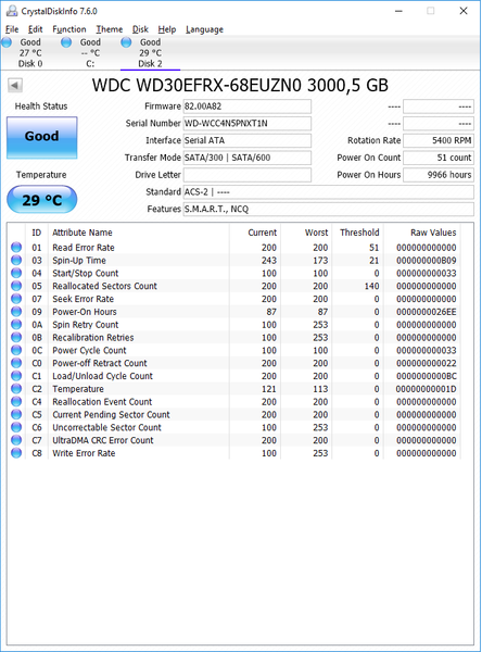

Hi. I've had some issues with my Readynas 102 recently. It has two drives in raid, drive 2 have been giving early signs of age for quite some time.(Detected high command timeouts happening once or ...

It's possible that something is wrong with the SATA port on the RN102.
Though perhaps try yet-another-test of the disk with WDC's lifeguard program in the Windows PC. Perhaps try the write zeros test (which is destructive), as it is closer to what happens in the resync than the normal non-destructive tests.

Thanks for the reply.
I'll do some testing through the night and report back tomorrow. I'm starting of the drive that should be dead (according to the NAS),
considering that the WD RED 3TB was working fine until i installed it in the 2-bay NAS.
Do you have any suggestions on how to troubleshoot the S-ATA connectivity? Would it be safe to export the system drive, test the NAS with two other drives, then cold-import the original system-drive afterwards?Also, here's a large part of the DMESG output from earlier today, complaining about bad sectors on the WD RED drive, which Im pretty sure is 100% fine.
