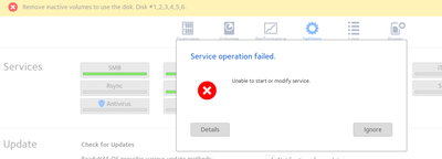

I have recently experienced some issues with my Readynas system. I found out that I had to replace the drive in slot4, which was working fine but about to fail. During the Resync process, apparently after it has completed successfully, slot0 drive failed and now I have two volumes data0 and data (image attached). I went through the KB and there are a couple of posts there about similar issues. I cannot enable SSH, therefore, still unable to explore any of what's been suggested.
New Volume
Please note that I've initially decided to replace this drive because the system started showing degraded Raid, specifically slot 4 in red from time to time. So I thought it would be better to replace this drive before it's too late. This problem (not able to access my nas) started  when the resync was completed (per the system log) but with 1 drive (slot 0 this time) showing disk failure (the disk is surprisingly healthy now). I was still -then- able to explore the directories and they were all there and it seemed everything was normal, thus, -because the system was showing red Raid- I decided that if I reboot the nas system all the reds will disappear and it'll go back to normal then will be in peace and I'll be able to access the nas with no issues, alas that wasn't the case. It seems this is exactly similar to this kb post:
Now it's asking to 'remove inactive volumes to use the drives'.
In an effort to try to resolve this, -when I restarted the Nas system and found out of the problem-, I tried to remove/ isolate the drive that was reported as failure during the resync (now working with no issue) in slot 1, inserted the old drive that was replaced back in its old slot (slot 4), hoping everything will go back to where we started and should have worked normal, but nothing, it's exactly the same red Raid and two data volumes data (27.7TB) and data-0 (0TB). After going through the relevant KBs, Now I probably understand why that may be the case, since the BTRF journal could have got corrupted as a result of the sudden interruption in the sync, and therefore the system could not mount back to the original data volume.
From the KB threads I've also come across these threads, which I believe share similar symptoms/ issues:
Please note that I could not get the SSH service enabled, could be to do with the volume mounting issue.
I've tried my luck with Netgear support, but it looks like they no longer provide support to this system.
Would appreciate any support that could allow me to mount back/ access the data volume.

      Your old drive is out of sync with the others, so adding it back will cause more problems, not fix them.  But since it didn't mount, probably no additional damage was done.
      Your "two volumes" are actually two broken halves of your old volume.  The NAS cannot properly mount them as one, presumably because of the failed drive.  Since drive 1 is the failed one, that may be the reason you cannot enable SSH.  I suggest you try booting without drive one, in read-only mode (using the reset button menu to do so) and see if that doesn't fix the issue (one accessible volume, though it will be "degraded) or at least let you enable SSH.  I may be wrong, but I believe read only mode still allows writing to the OS partition, which is needed to enable SH.  Maybe StephenB can confirm.
      • RN716x's avatar
        RN716x
        So follwoing what Sandshark has said, I am now able to see that the SSH service is enabled by default. I left it there for now, hoping to get some tips on how to proceed further.
