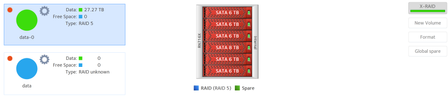

ReadyNAS 716X data- Two volumes after Resync
System: Readynas 716X F/W: 6.10.8 Old HDDs: 6TBx6 (WD Red) New HDD: 8TBx1 (WD Red) Raid 5 (X-Raid) I have recently experienced some issues with my Readynas system. I found out that I had to r...

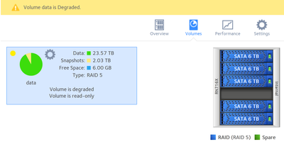

- RN716xJan 06, 2023Aspirant
Following option 2, removed sdd, connected sda in read-only. The difference is clearly narrower.
root@MaQBaLiNAS:~# mdadm --assemble --scan --force mdadm: NOT forcing event count in /dev/sda3(0) from 18988 up to 19055 mdadm: You can use --really-force to do that (DANGEROUS) mdadm: /dev/md/data-0 assembled from 4 drives - not enough to start the array. mdadm: No arrays found in config file or automatically root@MaQBaLiNAS:~# mdadm --assemble --scan --really-force mdadm: forcing event count in /dev/sda3(0) from 18988 upto 19055 mdadm: /dev/md/data-0 assembled from 5 drives - not enough to start the array. mdadm: No arrays found in config file or automatically - RN716xJan 06, 2023Aspirant
Quick update after restarting the Nas. Not sure if trying to reconnect sdd to resync would be a good option, hoping to have better redundancy till offload the data.
- StephenBJan 06, 2023Guru - Experienced User
I'm glad it finally mounted.
Don't add any more drives - that will start a resync process that will stress the failing one. If you push it over the edge trying to get redundancy, then you will lose all your data. Remember this whole mess started when disk errors on sda caused the resync to fail.
Just offload everything you can as quickly as you can - using what space you have now to get things started.
