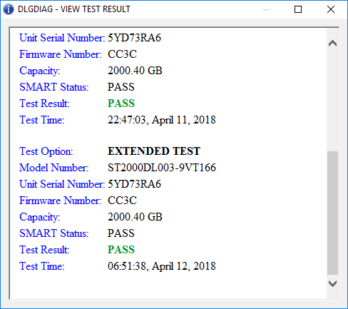

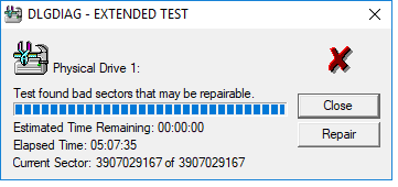

Performed the extensive/long test on the "broken" drive (ST2000DL003). The WD utillity reported a few bad sectors, that it appearently fixed (assuming it marked the sectors as broken). The test then finished as successful.
As expected I guess, being powered on for more than 5 years.... still managed to pass the test.

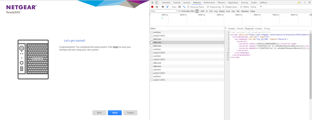

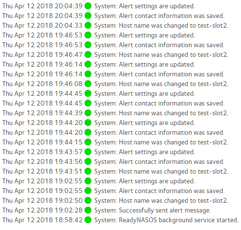

I fired up the NAS with the ST200D-drive in the second bay/slot, which seemed to work perfectly fine, however, the something caused the setup wizard to fail, preventing me from finishing (hitting the apply-button in the end did nothing, and the dev-tool in chrome revaled this:Apparently, something went wrong when attempting to set the admin-password....... but it seemed fine according to the syslog.

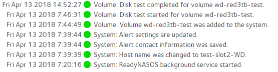

I then cancelled the wizard, created the volume, and ran the test, taking about 5 hours. no errors.

I shut down the nas, removed the ST2000 drive, wiped the WD red, installed it in bay2, and booted the nas again.
Went through the setup wizard, created the volume, everything seemed fine.Suggestions? I hoped this would bring me closer to a solution, but Im honestly more confused now....
