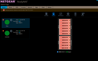

Hi there!   I had a power outage incident about a week ago. And ever since then my NAS is showing red for the volumes:

    Often this issue is caused by lost writes that were cached/pending when the system crashed.  That results in an out-of-sync volume.
    If that is the cause, it is possible to forcibly assemble the RAID array from ssh (or tech support mode if ssh is not enabled).  If you want to try that, we can give you some instructions.
