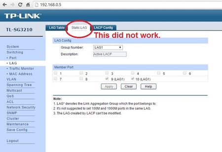

How I got Bonding to work with a TP-Link TL-SG3210 switch
Hello, I thought I would share, since I was puzzled how or why this happened to me and the switch I had. In the end, I got everything to work, and I do NOT think it is a NTGR issue, but if someo...

You definitely want LACP if you are bonding at the switch.
If you have an unmanaged switch, you can try "adaptive load balancing" on the NAS (with no configuration needed anywhere else).

The choices were Static LAG or LACP, I guess, but there is little documentation with that switch, so I had to guess.
